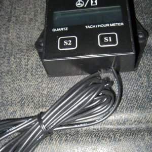

cheapo tach i got on ebay

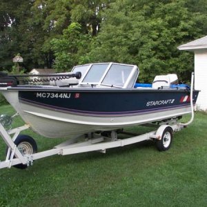

'88 Starcraft/Johnson 60

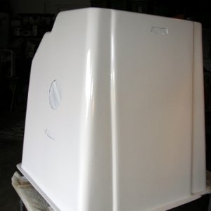

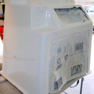

Shot the center console this morning. Applied a two part epoxy primer first and painted with Interlux Brightside. I tried to brush it first (bad idea)

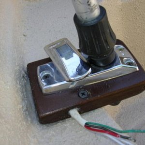

Stern light mod.
Jet Wrench
Jul 4, 2010
Stern light mod.
Jet Wrench
Jul 4, 2010

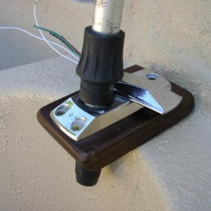

Stern Light mod. A reproduction stern light for this year Whaler is very expensive. I decided to make my own base with parts I got when retrieving the

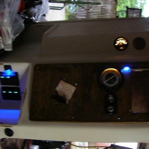

LED instrument panel lighting, lighted switches and internal gauge lighing illuminated for test.

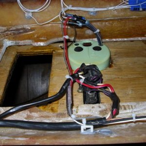

Behind main panel wiring.

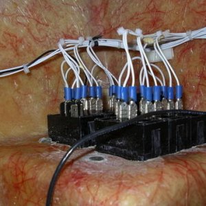

Switch wiring (all spade terminals are soldered in addition to the crimp)

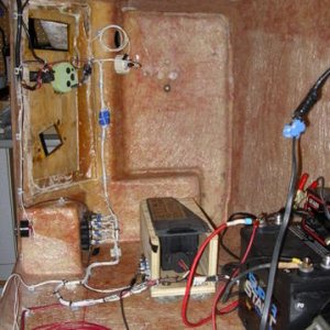

Console wiring: Started from scratch, used a sub fuse/relay panel from a Buick Sylark that contains my up/down relays for a CMC tilt/trim plate and fu

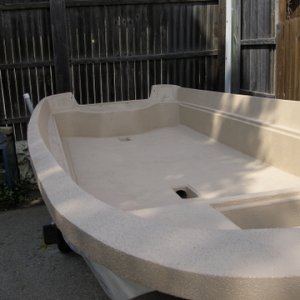

Durabak application.

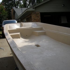

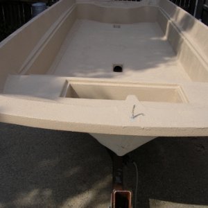

I decided not to re-gelcoat the interior... too much crazing. I decided to use a sand color Durabak anti skid material. Great waterproofing and looks

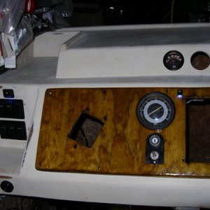

I decided to keep the wood for the instruments until after sea trials, then I will swap to aluminum. Oak stain and three coats of clear. I want to get

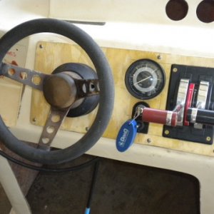

Designing the instrument panel layout

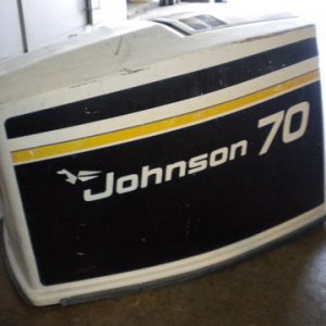

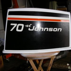

Cowling after paint

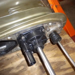

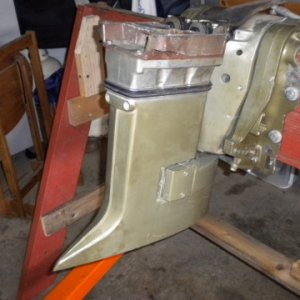

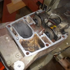

Patiently awaiting a new gasket for powerhead / lower unit assembly!

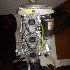

Freshly rebuilt carbs.
