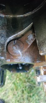

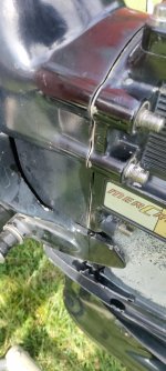

This job just got a lot deeper. As soon as I broke the seal, oil started dripping out:
28504ba0-bd93-429c-9c84-d47b07dcd58f.jpeg a2015b42-976b-4733-90b6-144bf1967095.jpeg

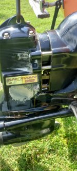

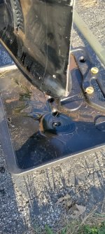

Once removed, it was a water-oil mess everywhere:

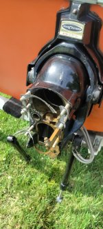

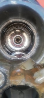

Tracing the oil, it leads up to the bottom of the input seal... so that's probably wasted:

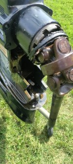

(The U-joint, on the other hand, feels good, not tight and if there is play, it's too faint to really notice)

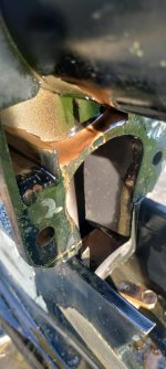

The shift cable/upper shaft didn't have much play and actually looked decent (although still the older design):

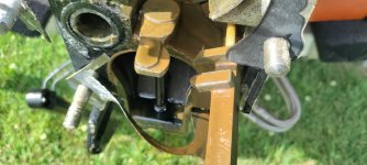

But... I did find the play. Lower shift shaft upper bushing is beyond wasted:
View attachment de77e707-1c7e-488b-913b-55c7a252e9a9.mp4
So, what am I looking at? An input bearing seal and the lower unit shift bushing of doom? Or are there other parts likely roached too? Looks like doing all the seals is a job to put it lightly... maybe look for a used Alpha 1 gen 1 drive in better shape for now and rebuild this one in the offseason?

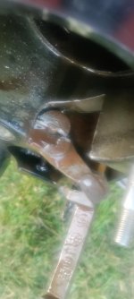

I also went ahead and pulled the upper shift shaft. For those reading this in the future, I did have to cut off the shift lever... but the reason wasn't corrosion (rather, what appears to be factory red loctite!). I did this using a oscillatory saw and a hammer/chisel:
006a7196-c53d-4dbf-acae-50837a3669b3.jpeg 3be1ffa1-e999-4f46-88ce-bc6a8a1625e6.jpeg

Here's the lake of leaked gear oil in the drive bellows:
(At this point is where I checked the gimbal bearing and found that it was pretty much pooched)
More of that mess on the drive side. Why I'm very sure it's the u joint seal that's the problem:

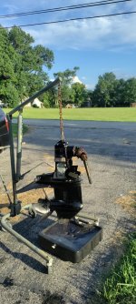

Here's my cheating setup using a "hoyer lifter" and the lifting eye that old drives like this happen to have:
Like the draining at the start of the season, streaks of milkshake in the drive oil. At least I now know where it's coming from:
The only other variables I see are any bearing misalignment (We shall see, I had to mallet the drive out at first but once the O-rings cleared the shaft pulled out without much fight) and the condition of the U-joint yoke's sealing surface; until I have the tool and can get the retainer out, I won't know. I do have lathe access via work (and via father-in-law) if it just needs polished but if that's also pooched, then sleeve it or replace it?
