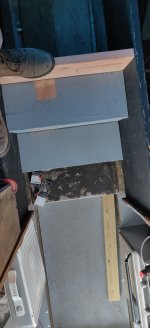

I finally got to find out what the stairs and raised cockpit deck area looks and feels like. Really liking it so far! Aside from the six 1.5 cu ft blocks of flotation down in the center stairwell section there is also a nice big empty storage area (I'm hereby calling it the hold!) measuring about 24"W by 30"L by about 3 feet deep. This will be an awesome place for carrying around random bulky items like a raft, or some beach chairs, or scuba gear, or stowaways, or hoards of lobsters, or a keg, or a crank driven margarita maker, or whatever- all out of sight. The steps aren't too steep or doorway too small which was something I was concerned about. Got the dining table mounted too. Converted it from the approx 2" pedestal post to one of the sturdier 3" ones like for chairs. Figure standardizing now is good for the most table and chair reconfig possibilities.
