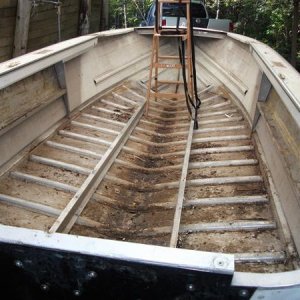

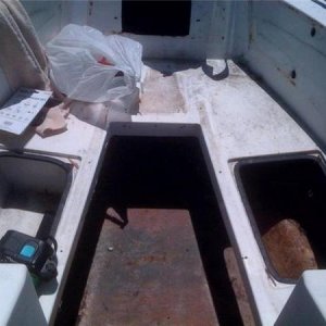

To get the fore deck to drop at a right angle so the trim work will mate up, I figure add at least three inches. The floor block could probably be fu
West Coast Willy
May 26, 2010

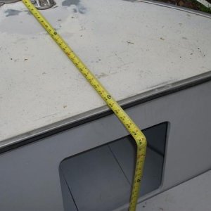

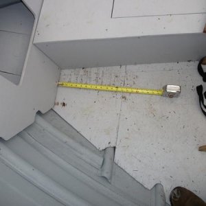

Since all these SCs should be the same, this is the length from last deck seam to anchor wall.
West Coast Willy
May 26, 2010

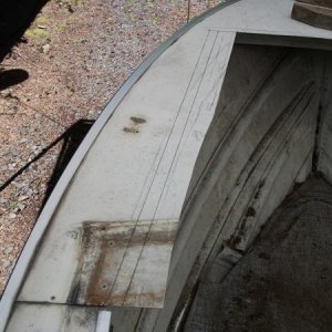

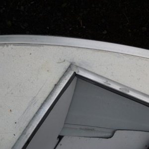

Need to use your imagination here. Used scrape molding held together by a hot glue gun to form template. Cut inch or so larger, then scribe to wall
West Coast Willy
May 26, 2010

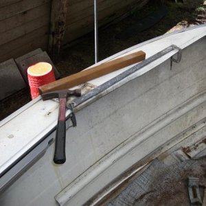

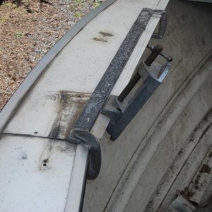

Starboard side trim fit. Notice holes in the salvaged metal. Someone had mounted pole holders and canopy hardware on them.
West Coast Willy
May 26, 2010

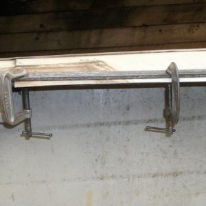

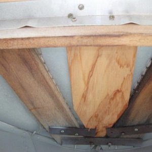

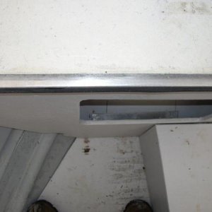

X-ray vision again here. This is how it's attached to deck and other is for interior shelf support. Note, had to have enough bow deck to attach 2x2.
West Coast Willy
May 26, 2010

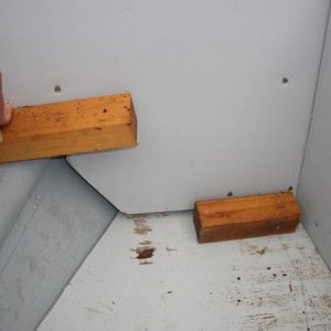

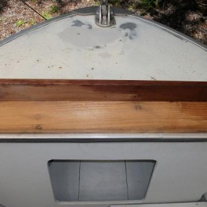

Use your x-ray vision here. I added a piece of 1x4 cedar, leaving the metal half inch longer to account for plywood wall. As will see later, should
West Coast Willy
May 26, 2010

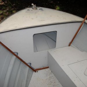

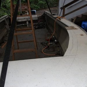

This is view under bow. When I started, my major concern for this area was size to accommodate anchor and rope, not how it would effect the finished
West Coast Willy

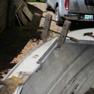

Port side trim fit.

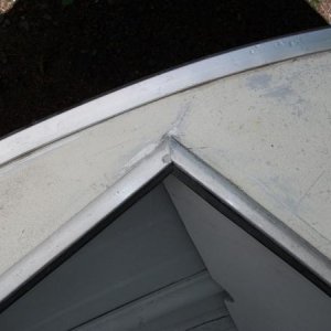

Because of that slant, the interior trim angles won't line up. The sides to match the existing trim had to be at 90 degrees so to solve that problem

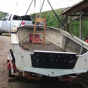

Someone said, experience is knowledge gained too late. Well here it is.. By not leaving the fore deck a little longer, the anchor storage panel slan
West Coast Willy
May 26, 2010
Since I've had no experience with the boat in the water I tried to approximate it's plane in the water by lowering trailer. Gives me a better "eye" o

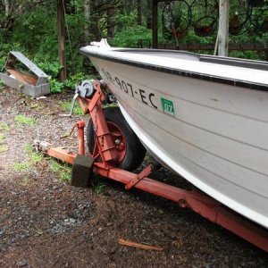

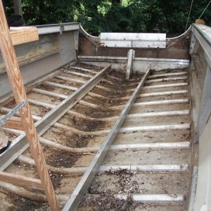

1987 16.2 Thunder Craft 015
